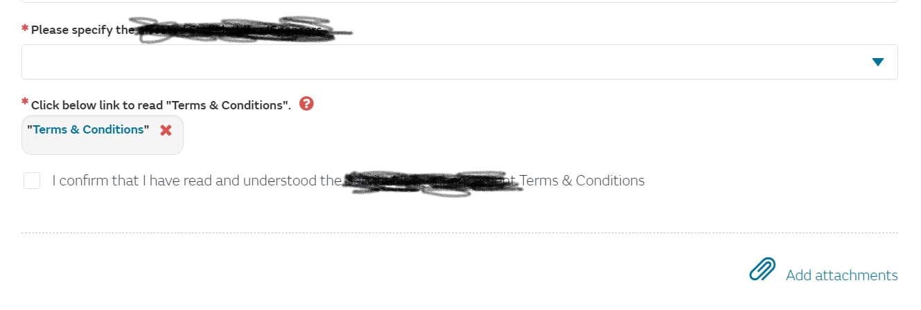

Hello ,
I want to make the add attachment icon mandatory in catalog item based on catalog variable value . Check attached screenshot for the requirement
How to do this ?
Sandeep Rajput
@harry24 Please refer to this support article https://support.servicenow.com/kb?id=kb_article_view&sysparm_article=KB0743672 to know the steps to make attachment mandatory on the Service
Portal. Using this example, you can check the variable inside the onSubmit script and throw an alert if the variable is true and attachment count is zero.
