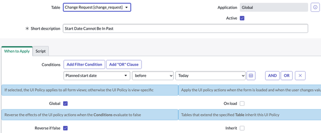

Hi @Jeck Manalo ,
Yes this was my recommendation , use UI policy to restrict future date selection...
If the use selects any future dates from the calender the UI policy would clear the field value starting 'No future dates allowed for selection...' and hence the value get cleared from the field unless correct date is selected.
Eg below is for past dates , you can apply conditon 'Planned start date' after today.
create ui policy action to clear the field value and show error message from script.

Hi @Jeck Manalo ,
You dont need to use Onchange client script for this. You can make use of UI Policy attain this..
Use clear value check box if the condition is not met so that you enforce the user to update the required info...
I hope this helps...

Hi @Jeck Manalo ,
