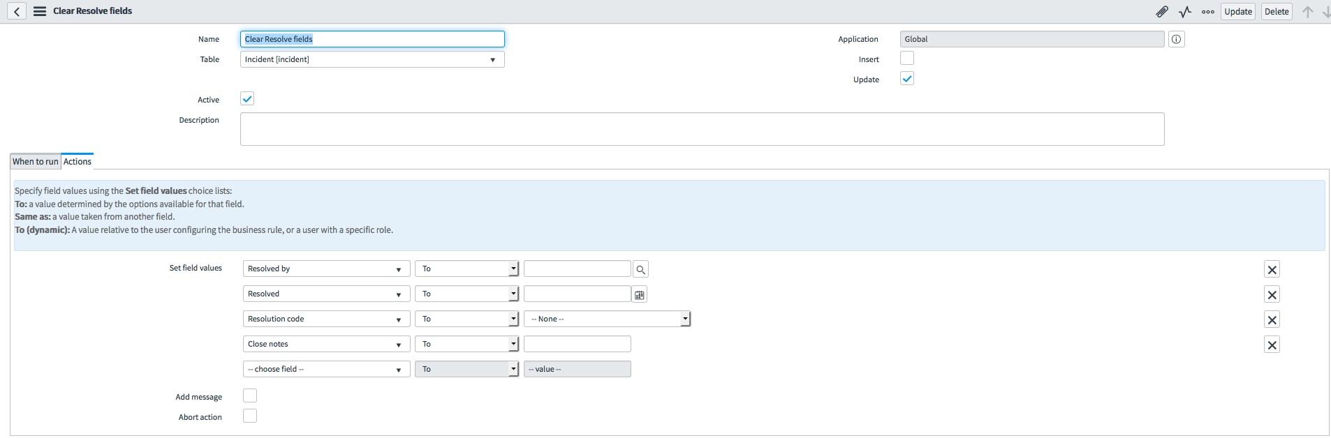

Hey guys,
Something which drove me nuts today as I was testing Jakarta on our Sandbox instance. (we are migrating from Helsinki to Jakarta now) and this is why I probably did not run into this earlier.
So I went ahead to test our incident management workflow and I ended up with all kinds of weird behavior - close notes would disappear, reset, resolution codes would act crazy...!?
And then I came upon the discovery of a newly introduced OOTB business rule (ever since Istanbul I guess) called 'Clear Resolve Fields' which is basically destructing all the custom logic we have in our incident management process (step of customer confirmation, custom templates for closure notes, etc. - I am sure some of you have similar stuff).
I deactivated that business rule and I am back to business and sanity:)
So just wanted to give a heads-up! Have a sunny weekend!

‎07-24-2017 04:09 AM
We are still on Helsinki, and have noticed this rule has been added in the last Maintenance Patch (which we applied last week) - I've had a look, and it doesn't appear to have been highlighted in the Patch notes, which means we only found out about it once our Service Desk noticed it.
‎07-24-2017 04:31 AM
Yeah, but have in mind that in Istanbul and Jakarta is it enabled by default and it does mess up your existing logic in the incident management process (if it's different from the OOTB one, which I think is very likely in 90% of the cases).
