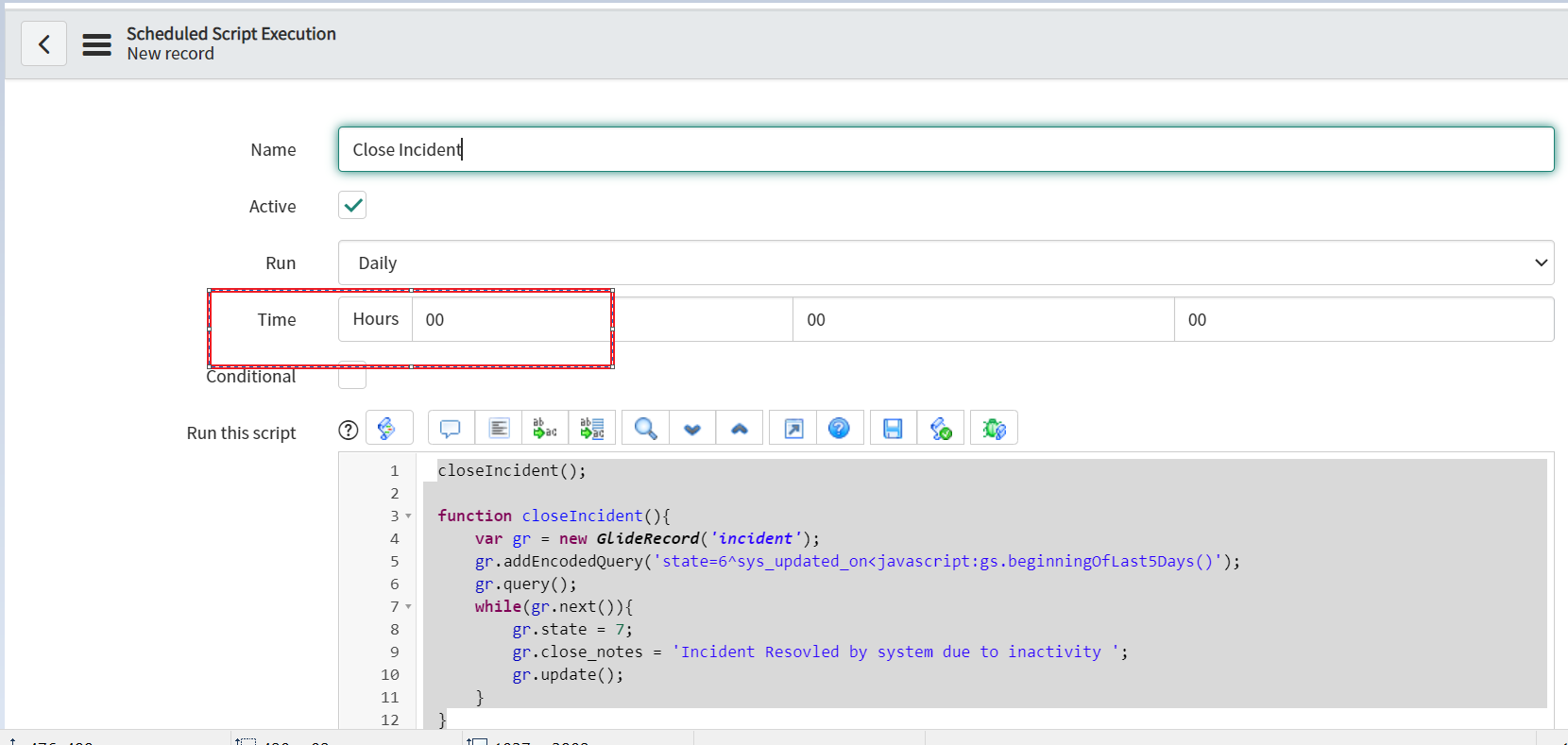

Hi @Siddharam Takali
So my suggestion and preferred method would be the above as shown. But still if this is for learning perspective and you want to write your own Scheduled Job then use the script below:
Script:
closeIncident();
function closeIncident(){
	var gr = new GlideRecord('incident');
	gr.addEncodedQuery('state=6^sys_updated_on<javascript:gs.beginningOfLast5Days()');
	gr.query();
	while(gr.next()){
		gr.state = 7;
		gr.close_notes = 'Incident Resovled by system due to inactivity ';
		gr.update();
Screenshot for reference:
Shloke
