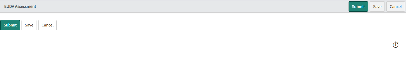

I have configured the following in the system.
- Created an Assessment Metric Type, with an associated Metric Category and Metrics
- Created a Flow in the Flow Designer to trigger an Assessment based on the above Assessment Metric Type
The Assessment is created successfully although it is empty! In more details the Metrics are not visible on the Assessment Instance.
Anyone who can assist on the above issue with any directions/suggestions?

Hi Jake,
Thanks for your reply.
Thought of using the Flow Designer since it gives more flexibility for complicated triggers.
Even if I use the condition triggering the same thing happens (empty assessment). Please find screenshots below:

Thanks for your swift reply.
Do records matching your condition exist? Yes
Is the assigned to field empty on records that match the condition? No, the assessment is created and send to the correct user
Are there any survey instances? This is an assessment not a survey. The second screenshot I shared with you is the assessment instance
Have you enabled public access? Yes the assessment metric type is published
