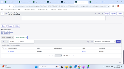

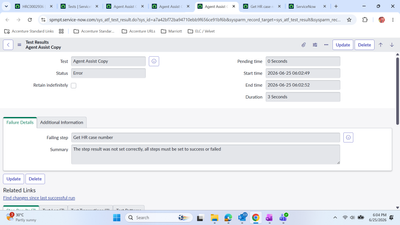

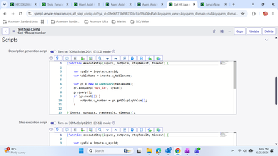

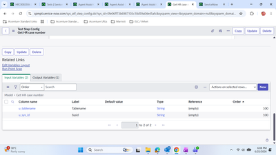

Thanks for the quick response but am getting a error as "The step result was not set correctly, all steps must be set to success or failed"
And i have also tried to set an else loop below the if, And it still failed with empty Summary in ATF
PraveenaD_2-1782391083945.pngPraveenaD_3-1782391088339.pngPraveenaD_4-1782391114983.png
Can you please help
@PraveenaD
you didn't do it properly in script
the error clearly says you should set either success or fail in your script
(function executeStep(inputs, outputs, stepResult, timeout) {
    var sysId = inputs.u_sysid;
    var tableName = inputs.u_tablename;
    var gr = new GlideRecord(tableName);
    gr.addQuery("sys_id", sysId);
    gr.query();
    if (gr.next()) {
        outputs.u_number = gr.getDisplayValue();
        stepResult.setOutputMessage("The number found.");
        // Set the official step status to success
        stepResult.setSuccess();
    } else {
        // Fallback or explicit failure logic
        stepResult.setOutputMessage("Something went wrong.");
        stepResult.setFailed();
}(inputs, outputs, stepResult, timeout));
