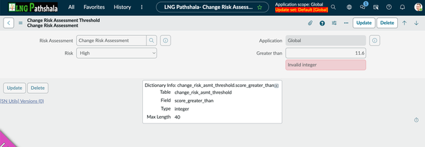

Hi @Community Alums
I tried this in the list view. When I enter a decimal value, it automatically converts it to an integer and does not show any error. However, when I open the record and try to enter a decimal value, it shows an error. You need to check where this validation has been added.
12-30-2025 08:02 AM - edited 12-30-2025 08:03 AM
The field is type Decimal.
But the is a business rule called Verify value that prevents you from using a decimal value. They must have a reason for this, I would not change the out of the box functionality.
