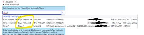

Hi Team ,
I have modified catalog item variable 'Requested for' variable attribute which refers to sys_user table, I could see proper result from SP portal but when i check it from native Ui Using try it is showing extra attributes? what is the cause for this issue? Kindly help.

This is from backend using try it button , i Could see same field twice here i.e user name

Hi @Bindhu1
You can remove name from the Reference qualifier and try.
The Display Value( which is name field for user table) will be shown by default.
