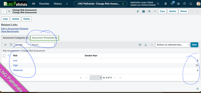

The risk calculation is based on the risk assessment and the risk conditions. From what I can see in your assessment, everything looks fine.  Did you also configure the risk thresholds?
For example:

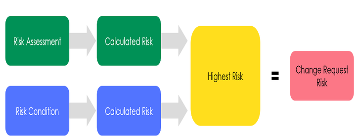

Hii @diegodossan
As per my experience, include all risk assessment questions only within the risk assessment and keep the risk conditions unchanged. This is because the risk assessment generates a risk value, and in parallel the risk condition also generates a risk value. In the end, whichever value is higher takes precedence.
Your risk assessment structure looks good; now you only need to increase or decrease the risk threshold or value based on the answers the user provides in the risk assessment. This follows the out-of-the-box (OOTB) risk assessment and risk condition behavior.
