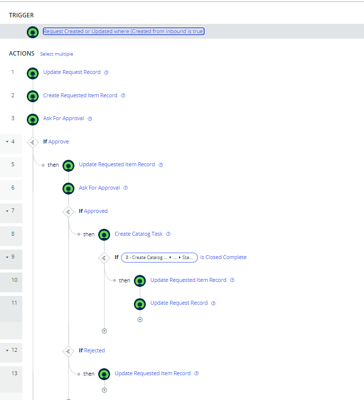

2) Second approach I have tried is that I have created flow designer where I have trigger condition as created or updated on "sc_request" when "created from inbound " is "True" ,Then I have written logic to create RITM and ask for approval and then created "sc task" ,But when sc task is created all fields on form are read only no ui action is working on sc task form.

Hello @Padmaja ,
I have read your second approach and as per my understanding it seems correct. But in ss there are multiple extra logic you have in the flow. Could you please specify that where exactly you have stuck in the flow executions?

Actually, in second approach Request and RITM is working as expected but when SC Task is creating then it is
looking as below screenshot, nothing is working on Sc task form no Ui action also description field is read only.
‎08-08-2024 12:38 AM
No any error occurred in the flow executions for create catalog task action right?
Could you please verify that action and please open that action and share that ss so, I am able to review it.
‎08-08-2024 04:41 AM
Hello @Dnyaneshwaree
There is no error in flow execution, please find attached screenshot
Also, All UI actions on SC task are out of box.
