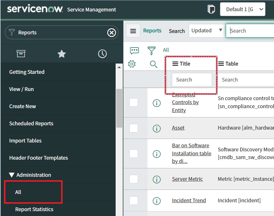

Hi @Himabindu
Couple of points to validate in this scenario to resolve this as mentioned below:
1) Can you impersonate the user and see if they are able to see or not? Do not rely on what User says sometimes they might miss something and are not following the correct path to view the report or may be viewing incorrect reports.
2) Navigate to All module under Report and search for that report after impersonating the user and see if it is visible or not as shown below:
