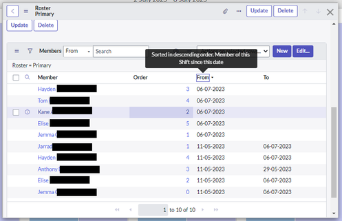

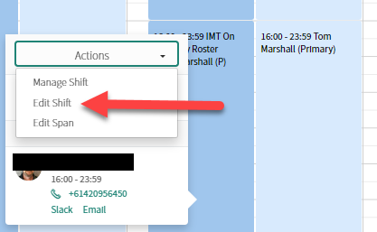

4. In the calendar go to the start date of the shift you want to start changing the rotation select Actions > Edit Shift
5. Select the roster you want to change (Primary, Secondary etc)
6.  In the To column add the end date of when the current rotation will end.
7. Then add the names back in by clicking on NEW and selecting the members with the new start date to begin rotation and then under the Order column add the sequence number they are in now to rotate through
8. Click Save/Update till you get back to the Calendar screen
9.  You will find the start date of the new rotation will reflect the new order.  You have the history of the old rotation in your calendar still for reference.

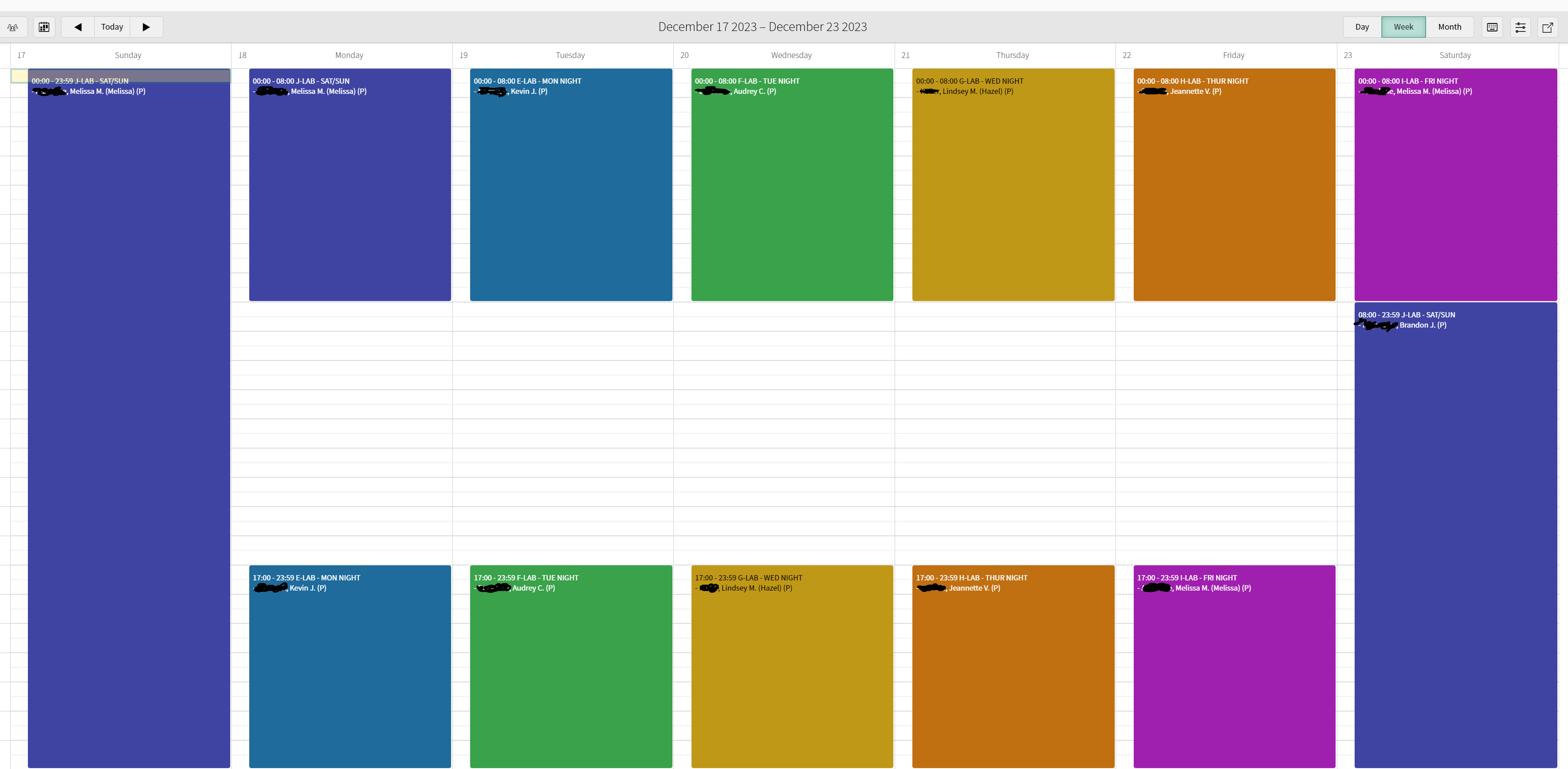

Beth Clingenpee
Hello - did this work for you? I have tried this and am not having any luck getting the schedule to show up on the new start date. I am using this in a slightly different manner - we have a team who has a very irregular rotation due to 1 member who doesn't take call on Fridays, so they are rotated in extra M-TH. I was able to make this work for 12 weeks of the schedule and was hoping to be able to repeat the schedule starting with the next 12 weeks. Your solution seemed like a good fit! Is there another step I'm missing? I've attached screen shots below.
