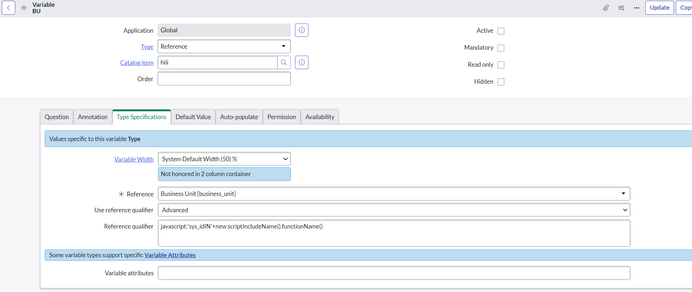

Hi @Tracy5
Script Include returns reference qualifier string e.g. "sys_idINx,y,z".
On the reference field, Type Specifications > Use reference qualifier > Advanced.
In the Reference qual field:
javascript: new ScriptIncludeName().FunctionName();
Example:
javascript: new PositionUtils().getPeopleLeaderUsersRefQual();
Note: Replace : with an actual colon.

dgarad
Hi @Tracy5 ,
There is no need of client script to restrict reference table data.
You can add reference qualifier on reference catalog variable.
You can even call the script include from the variable. You can write the logic in your script include so that it will return comma separated sys id's of the groups.

Hi @Tracy5
Example:
If my answer finds you well, helpful, and related to the question asked. Please mark it as correct and helpful.
dgarad
Yep this works, just need to ensure that the script include is callable by the client
