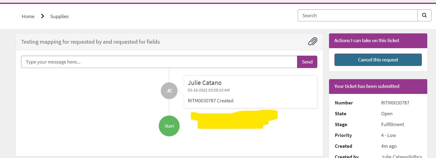

On the SCTASK form I added additional comments (customer viewable) and I can check the work notes box if I don't want it viewable to the customer.  When I made an update in the additional comments field on the SCTASK for I am not seeing the comment on the service portal under my request. (see attachment)  Is this a bug?

The screenshot is for RITM and you have added additional comments on sc_task record. Not on RITM. If you want to see those comments on Portal then either open SC Task record in portal or use logic to copy cooments added on SC Task to RITM.
Check below links for the logic:
https://community.servicenow.com/community?id=community_question&sys_id=b7e78b2ddb1cdbc01dcaf3231f96...
https://community.servicenow.com/community?id=community_question&sys_id=f3341ac8db20d0101cd8a345ca96...
https://community.servicenow.com/community?id=community_question&sys_id=e1578369db1cdbc01dcaf3231f96...

I understand when I status the ticket from the RITM it shows up on the service portal.  I added the additional comments to the SCTASK form but not seeing what I wrote from the service portal.  Attached is what our service portal looks like and where the customers would view any comments to their ticket.

If it is a request, usually the ticket conversations widget will display RITM, not SCTask. Try adding comments on RITM, it will be shown I guess.
