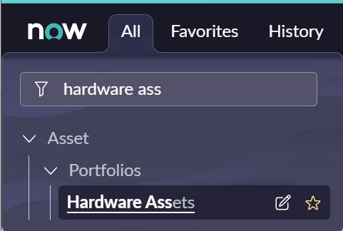

1. First i selected Hardware Assets using below steps from the Application Navigator

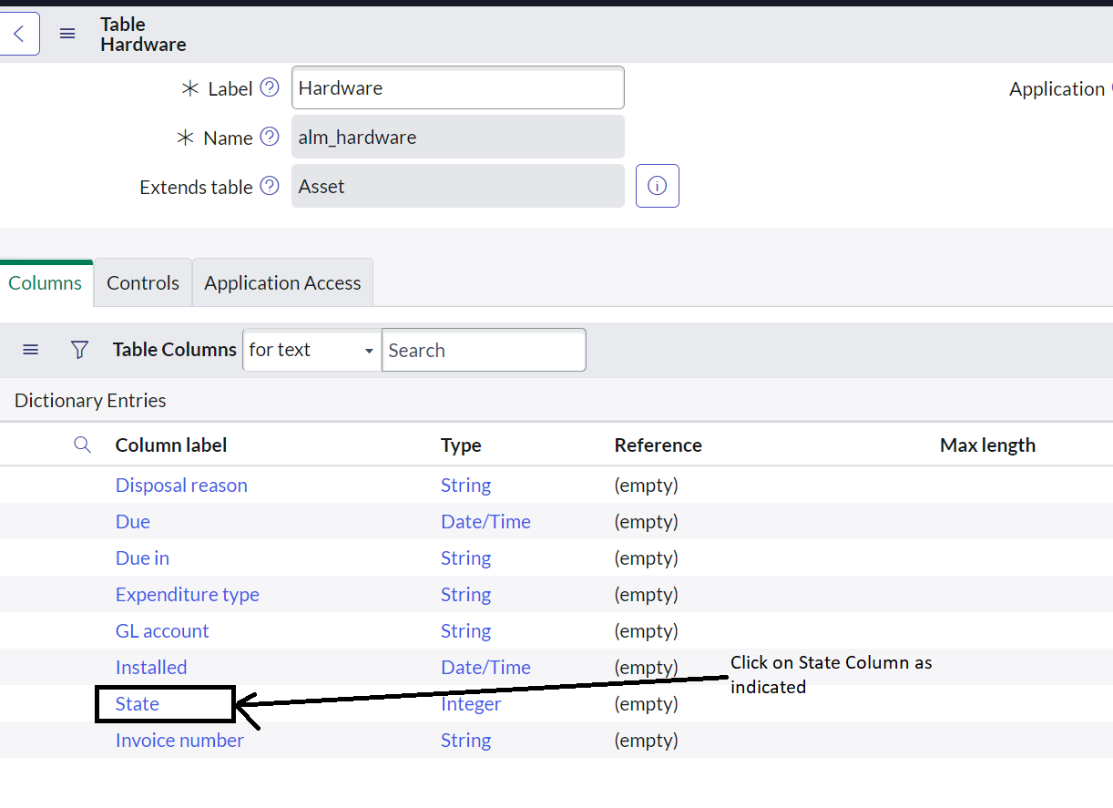

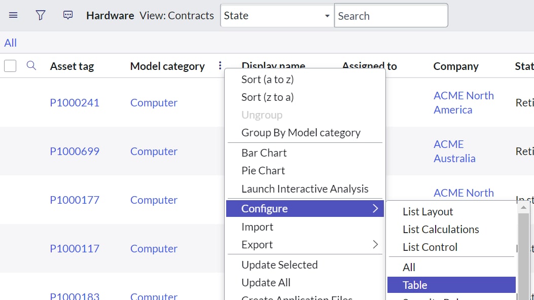

2. Slightly different to your step i picked a column display label in random to select the table name from the current view.
3. Next i clicked on the "State" column label as shown below.
4. Below screen will appear once you click on State column
You can double click on the label as shown below "In Stock" or just single click to modify/change values.
In my case i changed "In Stock" to " In Stock - Virtual" and once i updated the value, magic happened. All the CI Records with status "In Stock" were reflecting "In Stock - Virtual".
