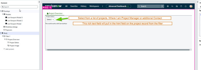

I want to create a filter on the project table in technical editor/UI Builder. I was able to add that however I cannot get content to follow that filter.
My use case: I want to select a project, then have a html field that is one the project record displays an image.

I got up to step 10 and then got lost because it is not a list but an html field. I must be doing something wrong. Alternatively, I have tried the steps with a list view and not html field just to get something working and still no luck.

Can you share some pictures of what you are trying to build so it will be easier for others to relate and provide the solution.
Filters work with parFilters JSON client state parameter which in turn calls the UX Client script include. so to implement the entire thing you need to elaborate what exactly you are building.
