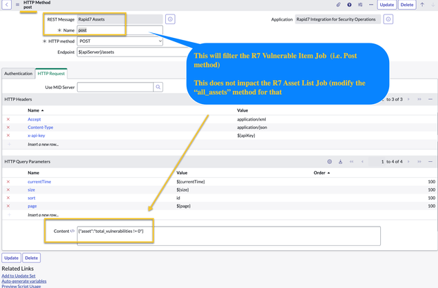

06-17-2026 05:15 AM - edited 06-17-2026 05:16 AM
Hey Ken - awesome, glad you got a win.
Yes - we would modify the REST Message > POST Method similarly here.
This will ensure that both the asset and detection jobs for R7 IVM, omit the VDI assets (or any other similar asset based filtering)
When the asset job runs, we would not pull these assets in to track with Discovered Items (or trigger CI Lookup attempts, create CIs if one does not exist)
When the detection/vuln item job runs, those assets will not be returned to ServiceNow based on the request sent to R7

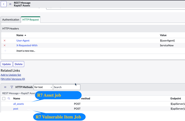

- Rapid7 Asset List -> You have to modify the "all_assets" METHOD
- Rapid7 Vulnerable Item -> You have to modify the "post" METHOD
- Rapid7 Vulnerable Item (Comprehensive) -> You have to modify the "post" METHOD
The integration jobs, R7 IVM Vulnerable Item and R7 IVM Vulnerable Item (Comprehensive) share that same single REST Msg > POST method, so we would adjust it once.

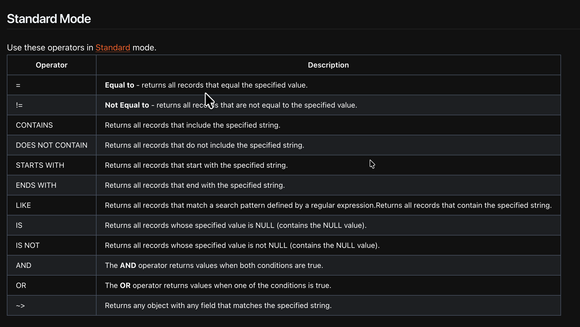

The R7 API can filter on the "asset" object and they have some neat operators as well like "STARTS WITH".
Example:
- {"asset":"total_vulnerabilities != 0 && tags STARTS WITH 'CROWN_JEWEL'"}

I created the tag "non-persistent vdi" and created a dynamic filter to add all NP VDI to the tag. Would I add the following to the "Content" box to import all assets except the non-persistent vdi's?
{"asset":"tags IS NOT 'non-persistent vdi'"} or
{"asset":"tags != 'non-persistent vdi'"}
06-16-2026 12:25 PM
Hey there,
I don't believe the equality operators will play nice with string fields on the R7 API (=, !=)
This seems like it should be a good starting point to implement and validate with:
- {"asset":"tags NOT IN ['non-persistent vdi']"}
