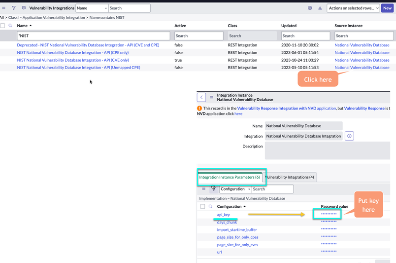

Grab a NIST API key here -> https://nvd.nist.gov/developers/request-an-api-key
Append it to the Password Value under the 'National Vulnerability Database' Integration Source
Try running the Unmapped CPE job again and see if you get a win and no longer run into the 403 error

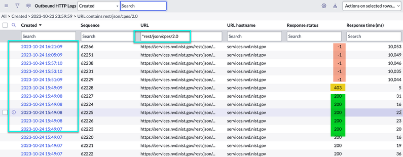

I got the API key and plugged it in as instructed, then tried another run. It errored out after 30 minutes with the following message.
andy_ojha
Hey there - copy that.
I see the same thing as well with the latest Store App and using a valid NVD API key.
Would suggest opening a NOW Support Case - so they can review and this issue gets tracked formally.
They may also ack this as a known / confirmed issue - and suggest the next steps...   An upcoming enhancement is coming to this Store App, and perhaps they may adjust how it works as of right now there does not appear to be a time based filter - and this may be NIST rate limiting the requests...
