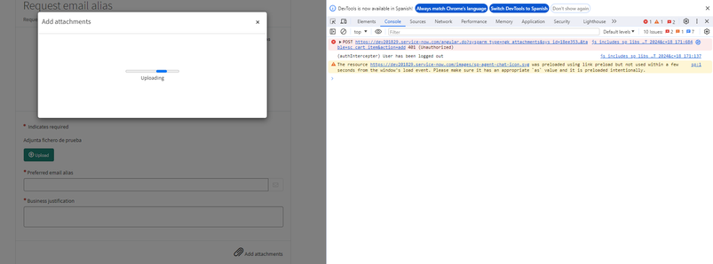

I have configured an item to public. It can be requested by an unauthenticated user. I manage to make the request, but when attaching a file it gives an error:
POST https://dev201829.service-now.com/angular.do?sysparm_type=ngk_attachments&sys_id=18ee353c937331102f4... 401 (Unauthorized)
I have tried leaving the glide.image_provider.security_enabled property to false.
I have tried removing the authentication required check in the attach WS POST.
I have tried giving creation permissions to the public and snc_external role.
All without success.
Does anyone know if unauthenticated users can be given permissions to attach files to a public item? If it is possible, how can it be done?

Hello @Damian Martinez. Thanks for your help.
In the end we solved it by creating a custom widget as a colleague posted here.
It didn't work but once we found the solution, we added the fix so that the widget works in the previous link. Basically you have to create a widget that attaches the file without using the API resource that requires authentication.
I hope it helps you.

Hello @Mario Sanz ,
have you tried debugging security rules to check which ACL is blocking access to attachment table?
Regard,
Damian
01-15-2024 07:42 AM
Hello @Mario Sanz further to my comment above, yes I have seen case where unauthenticated users can see attachments from URL, but not sure about uploading to the table.
01-16-2024 01:39 AM
Thanks Damian for your comment. What do you mean with "access to attachment table", ACL for table or ACL for End Point? I've tried ACL for sys_attachment without success. And if i should create an ACL for endpoint, I don´t know whata is the name of the endpoint.
