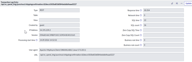

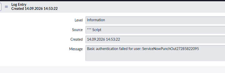

While the outbound PunchOut flow works as expected, we are currently facing a critical issue on the inbound path: the callbacks for Order Confirmation and Shipping Confirmation are failing due to an authentication error on the ServiceNow inbound REST endpoint.
Inbound Path (Failing)
When Amazon sends a Shipping Confirmation with corrext URL incl SysID, the request reaches our ServiceNow instance but fails at the authentication layer. Surprisingly, the Order Confirmation is not logged at all.
Under ServiceNow’s standard PunchOut setup, the Supplier Configuration only needs cXML credentials—no ServiceNow user account is required since authentication happens directly through cXML.

We suspect this is driven by an underlying API / Security Restriction, where ServiceNow requires specific web service permissions.
