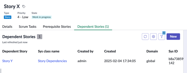

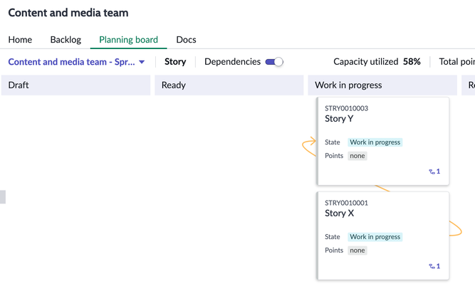

I don't clearly understand what you want to do but we can easily see dependency between 2 stories on Planning board.
I created Story X and Story Y, then make dependency for each story.
Story Y is a dependent story from Story X.

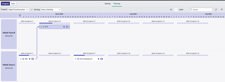

Story 'ABC' shows story 'XYZ" as a dependent story.

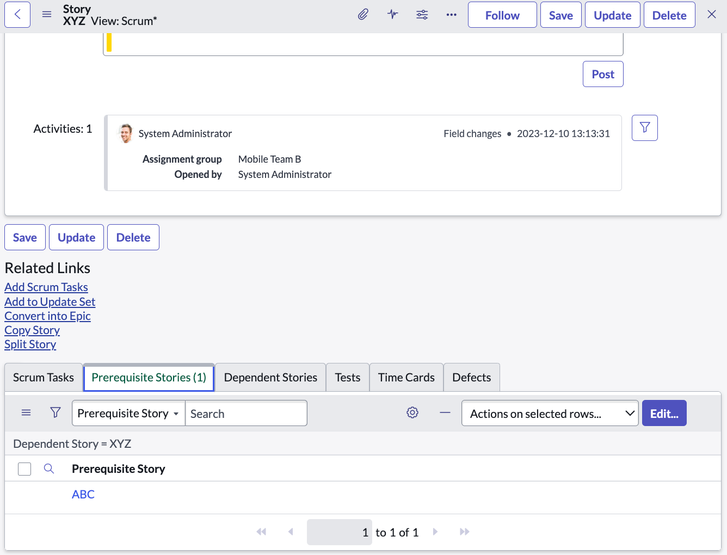

whereas 'story' XYZ' will show story 'ABC' as its pre-requisite.
Hope this clarifies.
