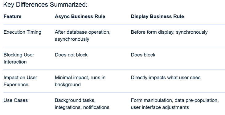

Hi @mrsahilmir1 ,
Async Business Rule:
Async BR are mostly similar to "after business rule", runs after the database commits a change. Unlike after BR, async business rule "run in background simultaneously with other processes." It allows system to return control early but may take longer to update related object.
Display Business Rule:
Executes when a record is queried from the database, before it is sent to the client.
Only runs when the record is loaded into a form (not on insert/update/delete).
Commonly used to pass data to the client using g_scratchpad.

Hi @mrsahilmir1 ,
Hope you are doing well in your learning. Here is explanation of BR.
An Async Business Rule is a server-side script that runs in the background after a user saves, updates, or deletes a record. Because it runs asynchronously, it doesn't delay the user's interaction; they can continue working immediately after submitting the form. You should use an Async Business Rule for long-running operations that could negatively impact user experience if run in real-time.
Common use cases include:
Making API calls to external systems (e.g., creating a ticket in Jira).
Performing complex calculations or queries that involve many related records.
Generating non-critical related records that the user doesn't need to see right away.
- Sending an email.
A Display Business Rule is a server-side script that runs before a record's form is loaded and presented to a user. Its primary purpose is to pass information from the server to the client-side (the user's browser) for use in client scripts.
It's different from other business rules:
Timing: It's the only type that executes before the form is even loaded. Other types (Before, After, Async) run when a user tries to save or submit a form.
Purpose: Its main job isn't to modify the database record but to prepare data for the client. It uses a special global object called g_scratchpad to act as a bridge, sending server-side information to the client. This is far more efficient than using GlideAjax for information needed on form load, as it saves a server round-trip.

Hi @mrsahilmir1 ,
Display business rule will work only when data is fetched from server side before form is loaded and values are populated. It will pick the values and will keep these values in g_scratchpad object.
Async BR - It is just like after BR but it runs only in the background. It is used when we ar emanipulating a lot of data. It will not block the screen and keep progress bar running. It will run in background and once completed, will display alert that it is done.
