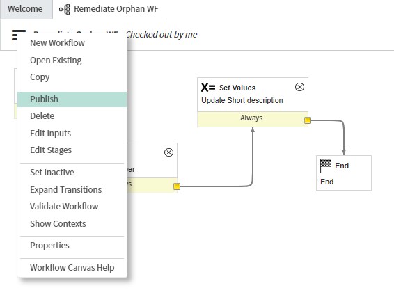

08-19-2022 05:23 AM
Here is what I tried
Created a workflow
- Name: Remediate Orphan WF
- Table: Orphan CI Remediation [orphan_ci_remediation]
Added 2 Core actions:
- Run Script
- Set Values
Connect the actions
- Begin
- Run Script
- Set Values
- End
Action: Run Script
workflow.scratchpad.currentnumber = current.number;
Action: Set Values
Short description
Workflow launched for task number ${workflow.scratchpad.currentnumber}
Finish your workflow
Do not forget to Publish your workflow!
After the workflow is finished Create a CMDB Remediation Rule.
- Name: Remediate Orphans
- Task type: Orphan CI Remediation
- Execution: Manual
- Workflow: [Your workflow name] "Remediate Orphan WF"
Set Health Preferences
In the category "Health Metrics" select "Orphan" Metric and activate "Create Task"
Last steps
Follow the steps 4 & 5 in the learning course and your task will be updated as following:
Happy learning!
If my answer helped you, please mark it as Helpful/Solution.
Thanks & many Regards - Manuel
