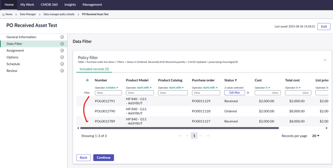

I have deactivated the Data Certification in UI16, and instead of migrating I chose to recreate it for experience. It's pretty simple, it checks the Purchase order line items (proc_po_item) table for any assets that were updated in the last 24 hours with a received quantity > 0 and the state is Ordered or Received. The filter shows the three records I expect to see in the certification task because they were created and received today.

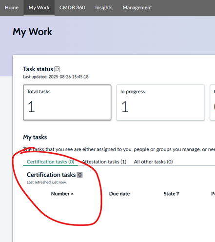

However, when the job is executed, no certification task is created. I have impersonated one of the users that will get the task, but it isn't there.

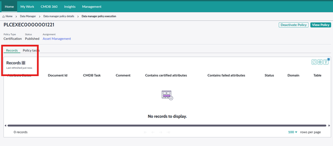

When I open the policy and view the executions, I see the same thing - nothing is created. Does anyone have any idea why this is happening?
