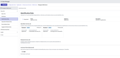

I am unable to see add under Identifier Entries when trying to complete lab:
Configure the CMDB Micro-Certification Simulator (Yokohama)
the part where it says:
Set Identification Rule:
Identification Rule
- Name: Mongoose Web Server rule
- Applies to: u_cmdb_ci_mongoose_web_server
- Dependent: True

For this, go to the CI Class Manager and search for the Web Server class. Under it, you’ll find the custom child class, where you need to define this.

I think you need to create the class itself and ignore the steps.
Then once it's created, you'll see the tabs on the left and add it (Note: I'm still working on this lab so I'm assuming it'll work but not certain)

Here's what you do:
* From the Web Server Hierarchy, click Create Class on the right
* Enter the name and table (Should autoset) and icon
* Skip past Add Attributes
* Set Identification Rules
* Click Replace
* Name, Dependent and table should already be set. Click Save
* You're done with Set Identification Rule
* Click on the plus below it to set Identifier Entries
* Use attributes from main table()
* Click next on General Settings
* Select Class and Running process command from left to right
* Click Save
You should be able to skip past the rest. Once it's added you can validate

@hikerclimber @PoonkodiS Did you guys created a new Child class under 'Web Server' as it clearly mentioned in the requirements.
Once you create a child class, then you can add Identification entries.
Go to CI Class Manager -> search for Web Server -> click 'Add child class' -> name it as u_cmdb_ci_mangoose_server -> go to Identifier section add entries.
Being part of the Cloud Dimensions CMDB implementation team, using CI Class Manager, you are tasked to create a new class that extends the Web Server class and new identification rule using the following information:
Provide Basic Info:
- Display Name: Mongoose Web Server
- Table Name: u_cmdb_ci_mongoose_web_server
- Icon: Web Server
Good Practice: Always start the name of any new CMDB table with u_cmdb_ci

This has nothing to do with the first set "Creatiing a child class"
It's the second step. I eventually figured it out but the given lab instructions by ServiceNow are entire inconsistent with the lab resolution
