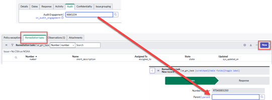

I was recently tasked with finding a way to populate a field on one form from another form. After doing some research, I learned that setting up a business rule was the best way to achieve this. On Form A, there is a tab named Audit that holds the Audit Engagement number.
Form A:
In the next section below, there's another tab named Remediation tasks. The ask is this: when a user clicks the New button from the Remediation tasks, the Parent field from the Remediation task needs to be populated with the Audit engagement number.
I put together the following script but have not had any luck:
// Only run if the issue field is set and parent is not already set
if (current.issue && !current.parent) {
var issue = new GlideRecord('sn_grc_issue');
if (issue.get(current.issue)) {
// Set parent to the sys_id of the audit engagement referenced by the issue
current.parent = current.issue.sn_audit_engagement;
current.update();
})(current, previous);

It seems your line with
is faulty.. You are trying to assign a GlideElement object and not its value.
Please try this below:
I would suggest you replace the GlideElement "issue" with "gr" or something else that is not a keyword.
var gr = new GlideRecord('sn_grc_issue');
if (gr.get(current.issue.toString())) {
if (gr.sn_audit_engagement) {
current.parent = gr.sn_audit_engagement.toString();
06-10-2025 02:21 PM
