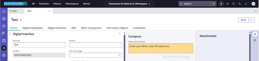

In the below form in my workspace , I'm wanting to add a new button that will take the user to a particular catalogue item on our service portal if one of the fields on the form has a certain value:
I don't have much experience with workspaces or UI Builder and I was just wondering if anyone has done something similar before.

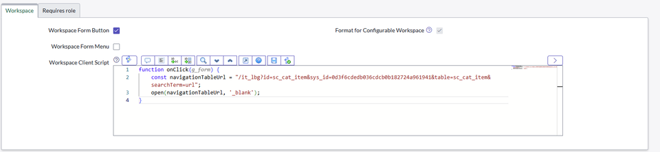

09-01-2025 01:26 AM
Hi @Its_Azar In my UI Action, what code would I need to put in to get the button to work. At the moment, the following doesn't work:
