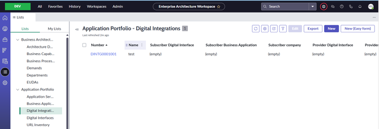

In the below list in my workspace , I'm wanting to add a new button that will take the user to a particular catalogue item on our service portal:
I don't have much experience with workspaces or UI Builder and I was just wondering if anyone has done something similar before.
