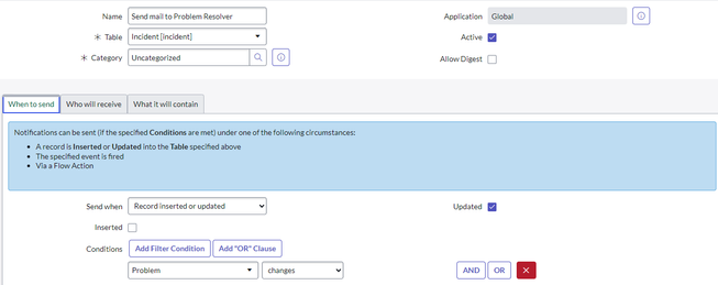

Head into System Notifications --> Email --> Notifications and create the following.

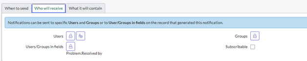

If you feel like you want to do it on insert as well then check the Inserted box . After that in the who will receive tab:
