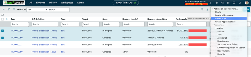

Hi @Javeria
You need to repair the SLA manually in that case.
https://www.servicenow.com/docs/r/it-service-management/service-level-management/c_RepairSLAs.html
