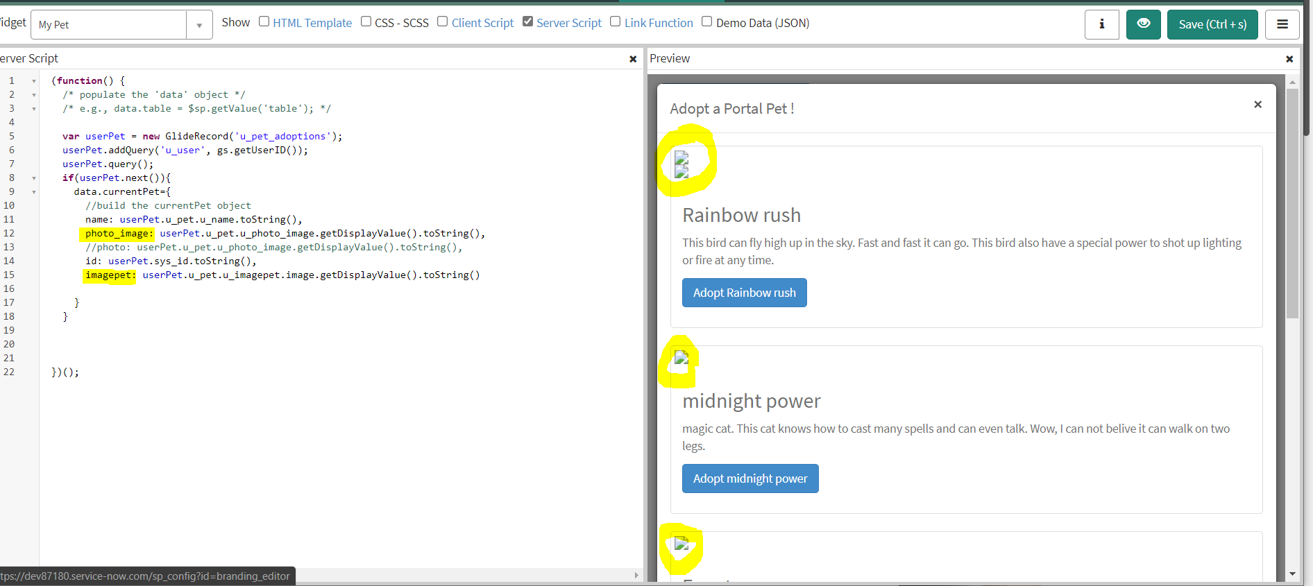

I have a question about portal widgets.
Please see attachments ... I have two widgets communicating with each other(widget 1 and 2).
(1st widget)
(widget called  my pet)
(2nd widget)
(widget called pet selection)
I have created a field variable for image which is a type image(Photo Image).
I'm just having a problem with understand why my images are not populating in the portal widget.
//Note this is extra info .
I tested my  widget HTML  image code  image tag(<img src=>  by going to the db_image table  and pulling  <img src =  > find_real_file.png It populated an image, so I'm confused. Please help me to understand what's really going on.
This was to test to see if an image would show or not  (note: this is ng-repeat, so the image will show up on all records first record to the End of list of records.
Note:
 I have a table called pets with all the records, but I'm still having issues viewing images in the portal widget.

In one of your widgets, you are writing: u_photo_image.toString(). Instead you need to write petsGr.getDisplayValue('u_photo_image');

I see, thanks. I have to correct the code line  >>petsGr.getDisplayValue('u_photo_image'); ('Cape R")
to this
photo: petsGR.getDisplayValue('u_photo_image'),
I updated my two widgets with this information.
 pet selection widget  changed code to ...
my pet widget changed code to ...
photo: userPet.getDisplayValue('u_photo_image'),
The pictures displayed on both widgets.
Thank you so much!!!!!
