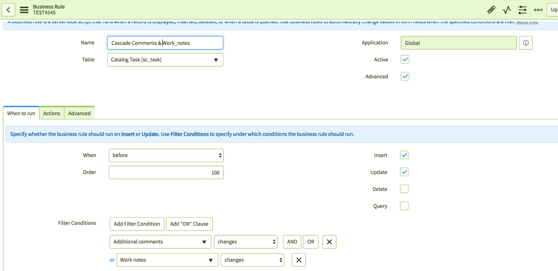

Not sure of already got the answer, got some time to do some testing as I promised and here is the test it did:
Type: Business Rule
Table: sc_task
Parameters: Run: Before insert and update
Filter Conditions: Additional comments or work notes changes
Script:
cascadeComment();
function cascadeComment(){
var gr=new GlideRecord("sc_req_item");
gr.get(current.request_item);
gr.work_notes=current.work_notes;
gr.comments=current.comments;
gr.update();

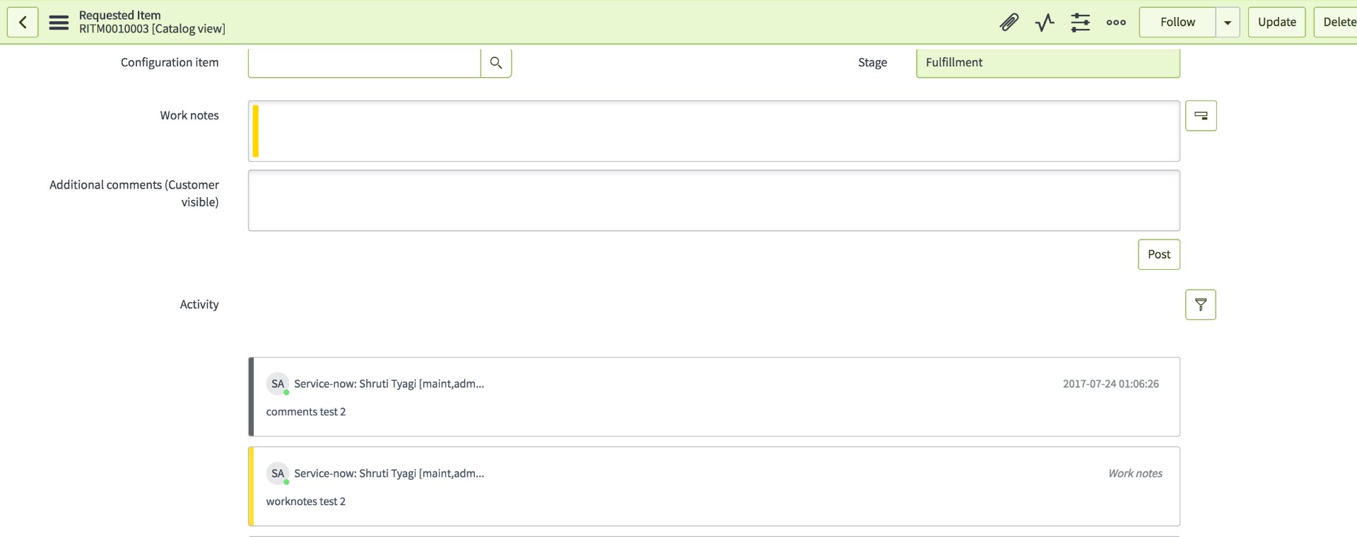

And I can see comments and work_notes are updated in activity formatter. Try this and see if this helps
