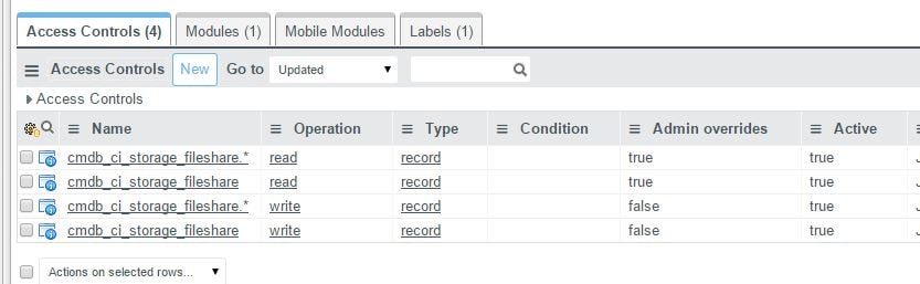

06-12-2015 10:56 AM
I see you only have 2 write ACLs, you also need a read ACL to grant the access to view the records.
06-12-2015 11:06 AM
Hi Michael,
Thanks for your reply but unfortunately, this does not work either. See updated ACL's below:
When I try and access the application which references this table as a normal ITIL user, this is the view that I get:
However, when I access this under an admin account, I can see the records in the table:
