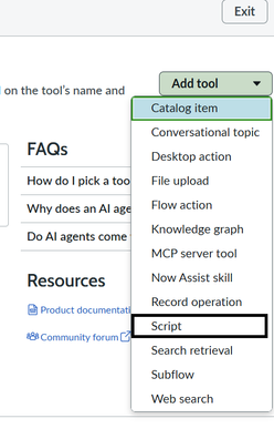

For this, the Suggested Tools say "Execute Action", but that is not going to do anything.
No options under "Add tool"
If I choose "Script" under "Add Tool" and go to choose an existing script, there is nothing for a Decision Table

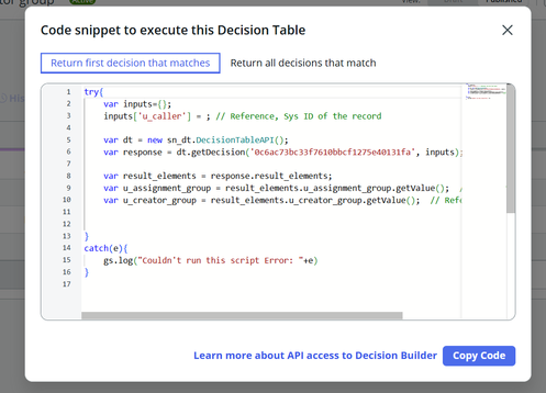

So to achieve this, you need to create a Script Action that uses the sn_decision.DecisionTable API to evaluate your table (DT Test) against the passed input.

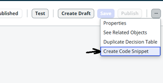

Navigate to Decision table > at right top corner :

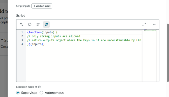

Once created, register that Script Action as a Tool in the Agent configuration. The Agent will then be able to call this tool, pass the input, and return the matched record.
