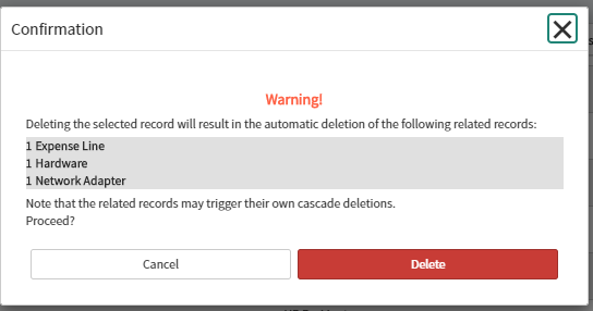

Hi Luis, is the confirmation message that you are using a ServiceNow dialog? Like the one that appears when you try to delete a record?
Or is it a browser dialog like this?
Cody
Hi Cody,
My dialog message is  the same as your 2nd screenshot(browser dialog)
