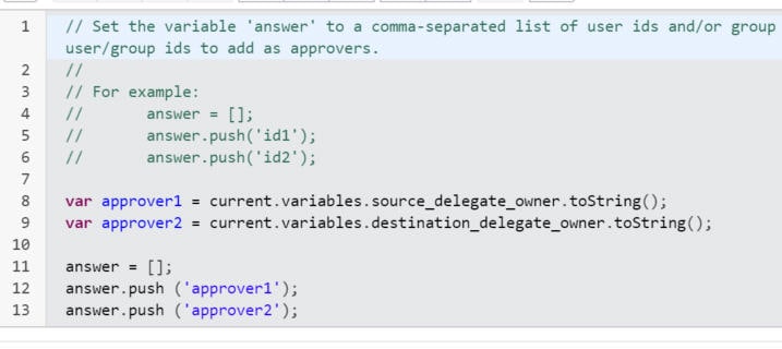

My goal is to get approval from 2 users on separate reference variables on the catalog item.
Can anyone tell me what's wrong with this workflow activity? When I run it, it always skips the approval.
05-15-2020 09:22 AM
12 line should be
answer.push(approver1);
13 line
answer.push(approver2);

05-15-2020 08:56 AM
make approver1= current.variables.source_delegate_owner.toString();
and same for approver2
Please mark my response as correct and helpful if it helped solved your question.
-Thanks

05-15-2020 09:22 AM
12 line should be
13 line
-Thanks
05-15-2020 09:16 AM
Hi Albert,
Since its already a variable you need to pass quotes('').
Use below,
