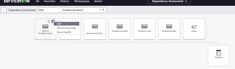

3. go to "Dependency assessment", select table in top row and select the custom table: "below I have utilized problem". Afterwards you can see again "all reports and indicator sources utilizing the table. On each you can click the contextual menu item and select "Show used by" which will drill up to dashboard layer.
