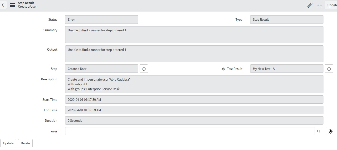

I noticed that our instance didn't come with Create a User in the ATF Test Steps.  I exported the Step XML from my PDI instance (Which works just fine) into our DEV instance.  It doesn't seem to want to work correctly, because every time I try to run the test, it errors out at the first step, which is "Create a User".
Below is the screen shot of the error I keep getting.  Anyone know what the heck is up with this?  I checked and

Yes sir I did.  I am sure it doesn't matter, but I noticed the input variables column of my screen shot and yours are different.  Now keep in mind, my instance is Madrid, I noticed in the Madrid PDI that ATF does not have Create a User as a Step Configuration.  However, my Orlando PDI does have it as a Step Configuration.  I exported it from my Orlando PDI into my Madrid PDI.  Could that be it?  If so, what could cause the Test Runner not to execute correctly?
any reason you want to bring the step to Madrid PDI and not use Orlando PDI
Because my company's Instance is Madrid, not Orlando.  That is scheduled for July.  We are looking to build the testing now instead of waiting.
