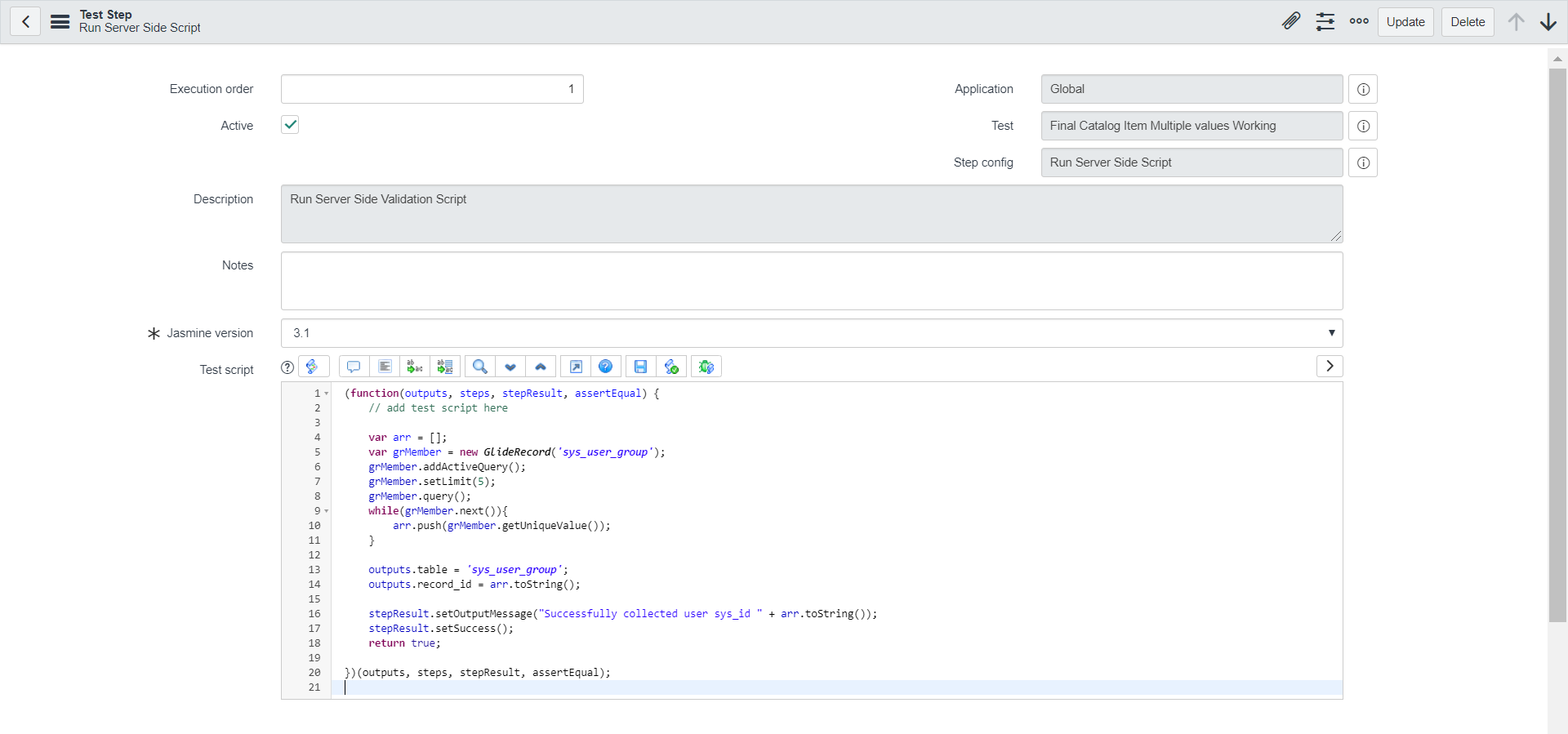

I was able to set the values dynamically using Run Server Side Script
please update code as below in the script; see screenshot as well
Ensure you determine this and then open the catalog item and then set the values
(function(outputs, steps, stepResult, assertEqual) {
	//set up array for output
	var users = [];
	// pull out first 2 active members of sys_user table
	var gr = new GlideRecord('sys_user');
	gr.addQuery('active','true');
	gr.setLimit(2);
	gr.query();
	//build array of two users to output
	while(gr.next()){
		users.push(gr.getValue('sys_id'));
	outputs.table = 'sys_user';
	outputs.record_id = users.toString();
        stepResult.setOutputMessage("Successfully collected users " + users.toString());
	stepResult.setSuccess();
	return true;
})(outputs, steps, stepResult, assertEqual);
	var users = [];
	gr.setLimit(2);
	gr.query();
	while(gr.next()){
	return true;
