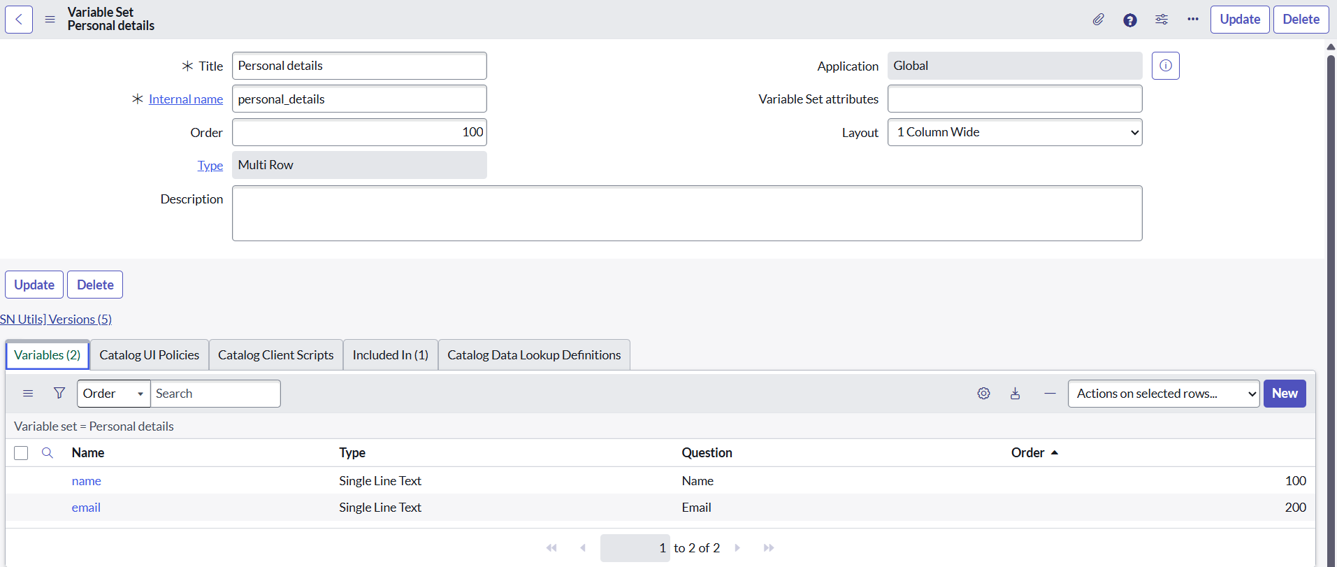

1- Variable set
2- Varible set:-
Variable Set 1: Personal Details
Variables: name, email
Variable Set 2: Personal Details_Read
Variables: first_name, old_email
These are read-only, and should be auto-populated from the above(Variable Set 1).

Thank you for your response. However, it seems it's not working- the value is not getting auto-populated in the field.
