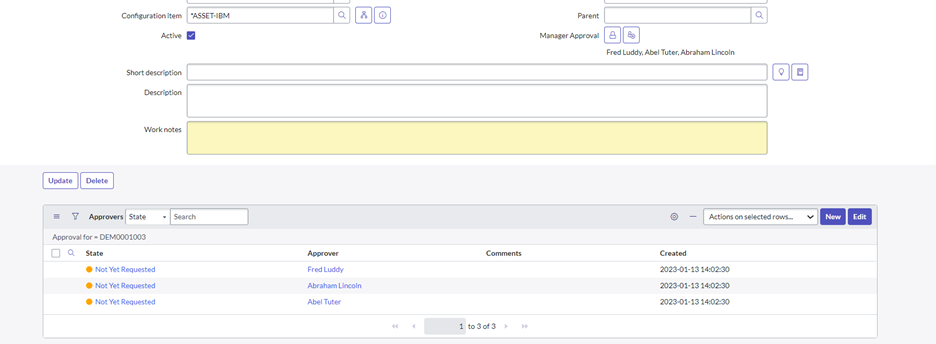

Hi ,

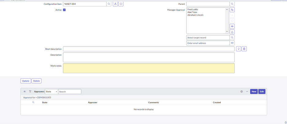

I'm Omkar, I have a requirement to do dynamically add or remove approvers in approvers related list based on list field using business rule. Could you please suggest me solution for this requirement . I was able to do insertion but unable to do removing the approvers based on that list field dynamically. If I write GlideRecord.deleteRecord()  or GlideRecord.multiple()   (table is sysapproval_approver), it's showing an error like following picture even I had given  delete  operation access to my scoped application for Removing.
For Example:
I added Fred Luddy , Abraham Lincoln, Abel Tuter in the list field , then those should be added in approvers related list . If I remove Abel Tuter from the list field ,then he should be removed from the approvers related list.
Please suggest any solution for this or suggest me any approaches for this requirement.
