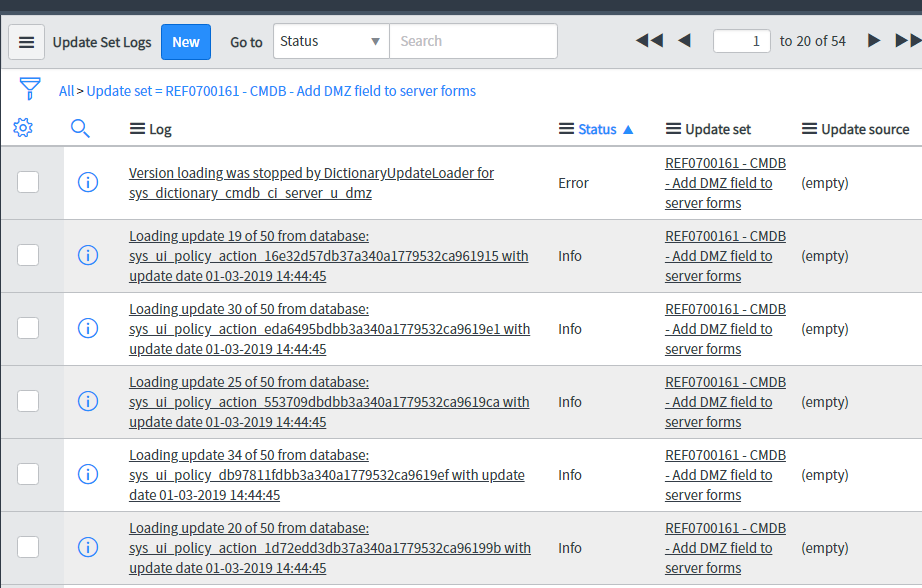

Hi, I have removed parent in dev, gone onto test - retrieve, preview and commit but only part of the update set has been applied. so most of the change has not been applied to the test environment.
How do I get around this?
What wasn't loaded? The only thing i see is the version error, which is likely because there is newer version info in test than was in your update set.

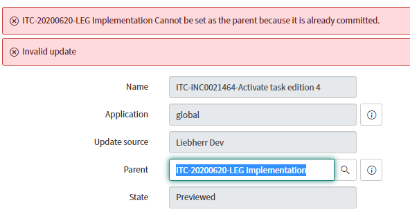

Hi Andrew,
I tried to work with batch updates since few changes. However, I'm stuck in the scenario provided here by @johnrob18. I'm using SN Orlando. Here is the scenario:
  1. I had a batch base with 2 child update sets in DEV
  2. I set them both as "completed"
  3. I moved them all to the TEST / UAT instance
  4. Now I've a fix in DEV (#4 - see below screenshot)
  5. I put it as "completed" and move it to TEST
  6. Before committing the fix in TEST, I tried to set the batch base or its child update set as parent, but couldn't. It's because they are already committed. When I do it, I get this error message:
On the other hand, I tried to set this child / parent relationship in DEV, but when I do it then I can't retrieve the batch base anymore from TEST, except if I delete it from there. This is anyway not a good practice.
Would you be able to bring light on this ?
Best regards
Julien
