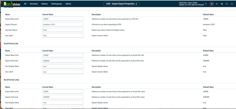

Dr Atul - LNG
Hi @Tejas Adhalrao
Short-term solution:
Change the export/import property limit and then download the data. However, this activity should be performed during off-peak hours to minimize any potential impact on other users and system performance.

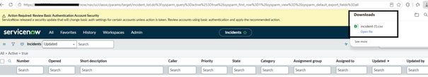

yashkamde
Hello @Tejas Adhalrao ,
Navigate on List Layout set the filter you want and above in the url append this line at the LAST :
https://devxxxxxx.service-now.com/now/nav/ui/classic/params/target/incident_list.do%3Fsysparm_query%...&CSV&sysparm_default_export_fields_all=true
as far as I know this exports records upto 1 lakh at a time.
