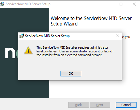

Cannot install MID Server as the ServiceNow MID Installer requires administrator level privileges prompts even though I am trying to install it as an administrator. I also tried from elevated command prompt and still gives the same error.

Have you tried to install it from command line?
If this is linux OS, you can try with root account.

Thanks for the quick response, yes I did try using the elevated command prompt and still gives the same error and its Windows OS.
This looks like policy issue with this host in your organization.
Below should be helpful
https://community.servicenow.com/community?id=community_question&sys_id=19210bed1b2a98d0d2ccea89bd4bcb76

If you're having issues with the windows MSI file, I'd recommend falling back to the ZIP file process:
