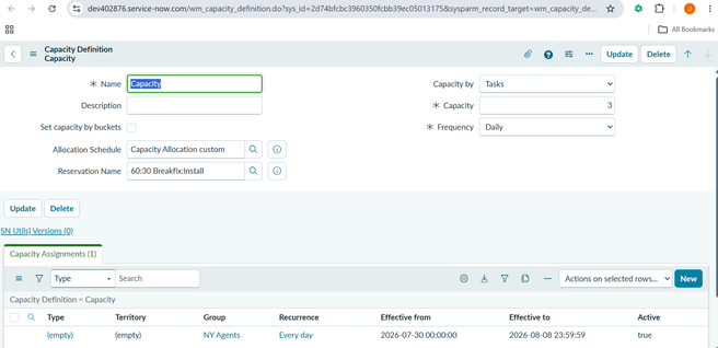

I have configured a capacity definition and reservation rule for assignment of work order task to agents. According to the capacity each agent should get assigned only 3 task per day. But the configuration is not working properly. I have created a 60:30 Breakfix:Install reservation rule as well that for the day agent should get 60% of break work order task and 30% of Install work order task. But dynamic scheduling is not following the reservation rule. I am not getting any warning as well for capacity breached or reservation breached if I am manually dragging the work order task in order to see the warning message.
Can anyone suggest why capacity and reservation configuration is not working.
Any help would be much appreciated.

I am not able to find Field Service > Configuration to ensure "Enable Capacity Management" is active, and verify under Dynamic Scheduling Configuration for wm_task that the "Agent Capacity" rule is explicitly listed as a mandatory hard constraint. In Dynamic scheduling matching rules I am able to see "Sort based on Territory rank and capacity " but it is not getting applied as it is on territory table.
The members in the group are correct. Please let me know the correct configuration changes as the ones you have mentioned are not in Australia release instance.
