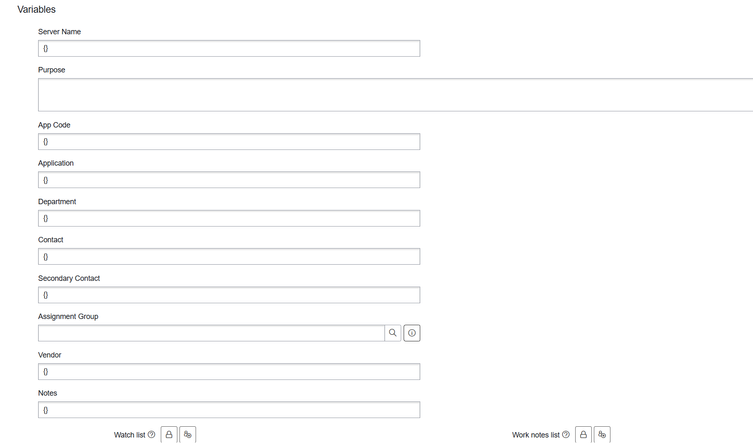

I am trying to create a ritm for each of a particular type of record from a custom table. I am getting the req, ritms, and tasks normally. However, the variables are displayed as '{}'.   Here is a screenshot of the issue:
Here is a snip of the code that I am using to create the variables:
        item = ({
            'sysparm_id': 'df9051da879fe21027c6426d0ebb35a8',
            'sysparm_quantity': '1',
            'sparm_requested_for': 'XXXXXXXXXXXXXXXXXXXXXXXXXXXXXXXX',
            'variables': {
                'server_name': helperGR.u_name,
                'purpose': helperGR.purpose,
                'app_code': helperGR.u_app_code,
                'application': helperGR.u_application,
                'department': helperGR.u_department,
                'contact': helperGR.u_contact,
                'secondary_contact': helperGR.u_secondary_contact,
                'assignment_group': helperGR.u_assignment_group,
                'vendor': helperGR.u_vendor,
                'notes': helperGR.u_notes
I have placed messages into the loop and the helperGR.u_XXXX values look to be correct. I am sure I am missing something but I am chasing my tail at this point.

Hi @NeoGeo ,
try this
 item = ({
     'sysparm_quantity': 1,
     'variables': {
         'server_name': helperGR.u_name.toString(),
         'purpose': helperGR.purpose.toString(),
         'app_code': helperGR.u_app_code.toString(),
         'application': helperGR.u_application.toString(),
         'department': helperGR.u_department.toString(),
         'contact': helperGR.u_contact.toString(),
         'secondary_contact': helperGR.u_secondary_contact.toString(),
         'assignment_group': helperGR.u_assignment_group.toString(),
         'vendor': helperGR.u_vendor.toString(),
         'notes': helperGR.u_notes.toString()
use toString and try

NeoGeo
Chaitanya you are my hero! This 100% solved my issue.  Thanks for your speedy and insightful answer.
