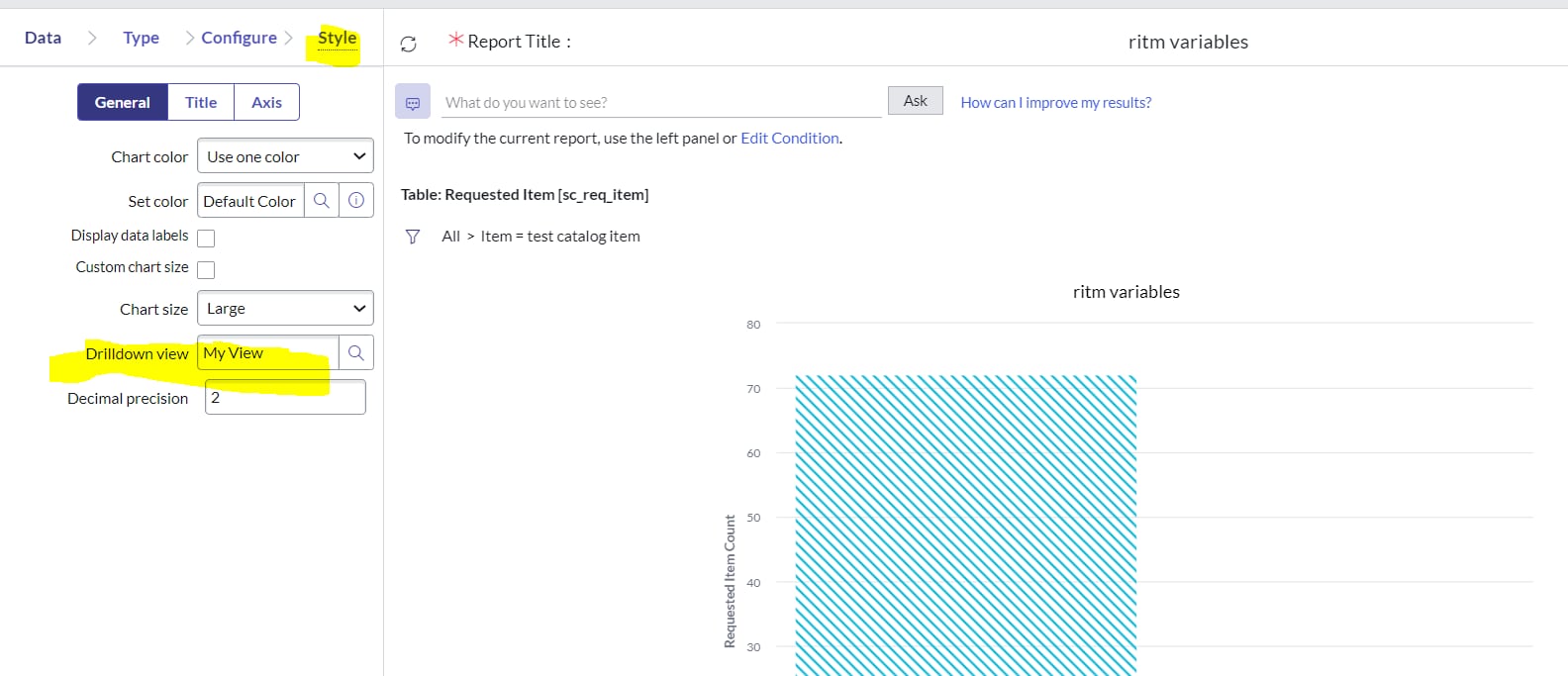

Hi Gousiya
You should set the drilldown with the view you need,
Onclick of the bar in below example will open the records in 'my View'.

â03-03-2022 06:13 AM
You dont see that option for drilldown or not able to select that view in drilldown?
Are you admin/report admin? If yes can you settup the drilldown and check.
You mentioned that view is only visible for role sn_esm_agent and that user doesn't have that role but still able to use the view in case list? Looks like the issue is here and not with report.
