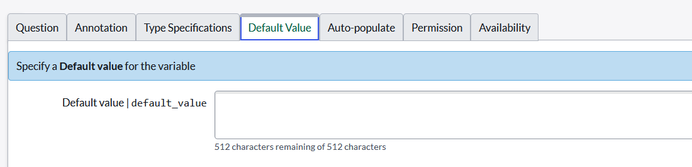

Karan Chhabra6
Hi @HemaLatha Koyya ,
You can set the default value of any catalog variable by specifying it in the default value filed on the variable record
You can show/hide fields via UI policies as well.
