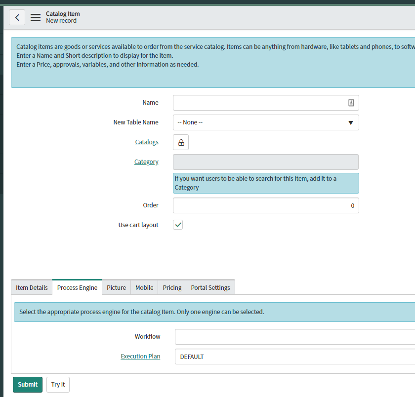

Hello there, hopefully this is a quick issue that's eluding me but I enabled the com.glideapp.servicecatalog.flow_designer plugin so that I could build flows that integrate with Service Catalog items.
That all went fine, however now that my flow is built and I want to assign a Catalog Item's process engine to the newly created flow, the flow option is not available under the Process Engine tab. Am I missing a bit of configuration?

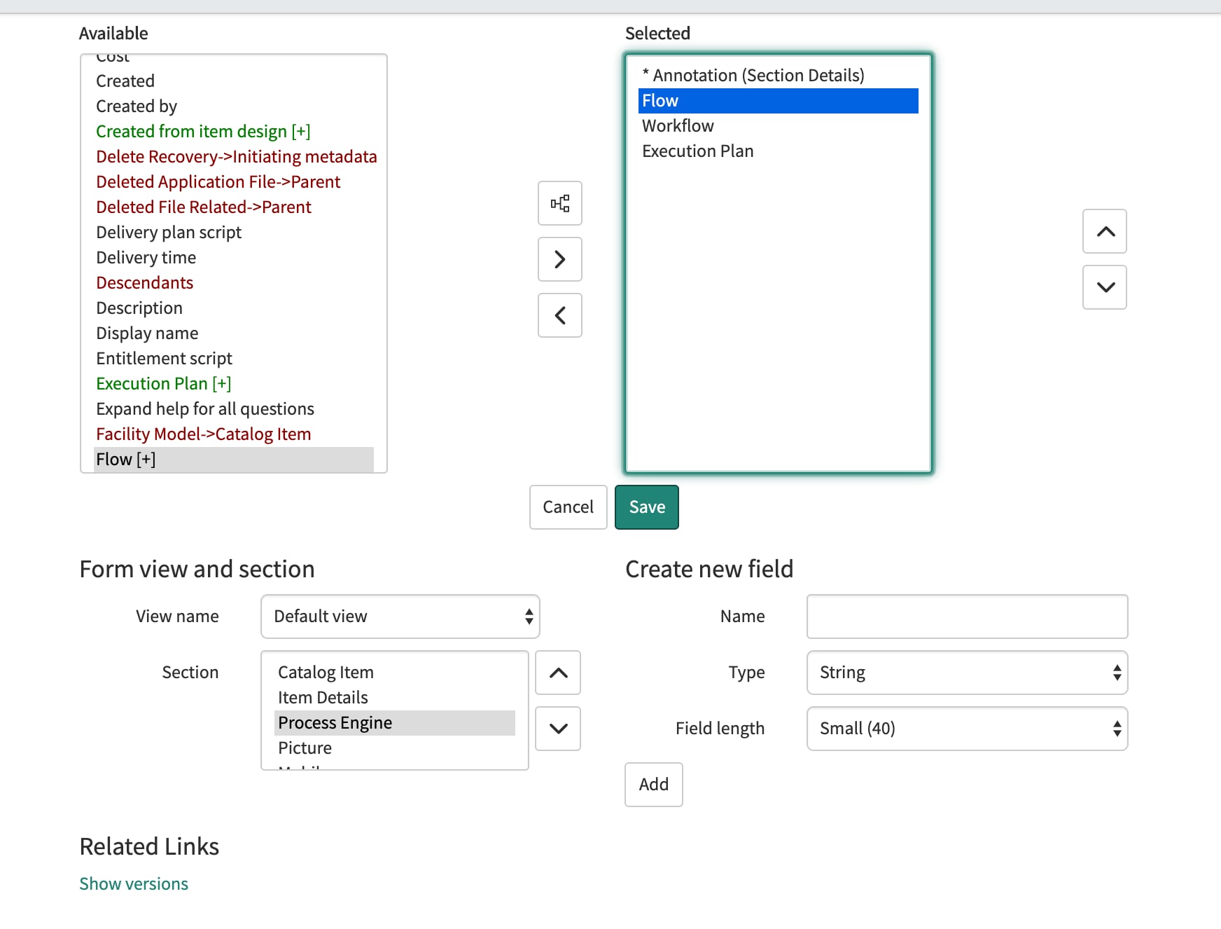

Hi Ararana,
You may have to add the 'Flow' field to the Form Layout.
Right-Click on the header go to Configuration > Form Layout
The select the "Process Engine" section and move "Flow" from the left to the right side
Let me know if that solves it!

07-15-2019 01:48 PM
That did the trick, thanks Josh!
