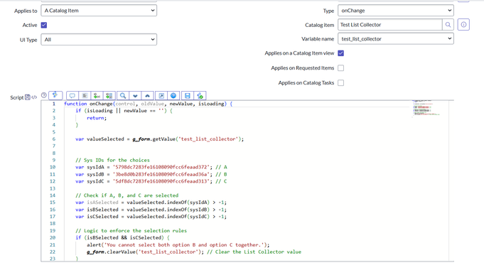

I have created a List collector Variable in Service Catalogue and created their 3 choices ( A , B , C) and get it referenced through question_choice table. Now the requirement is that when I select the B choice then I should not get the option to select C option and vice versa. But for Option A , I can select all 3 choice.
Please assist.

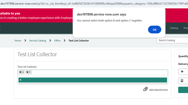

I have tried in PDI . Its working as expected . PFA code and screenshot for your reference.
Note:- I have used hardcoded sys_id of choices.
Explanation:
  1. Selection Rules:
    • If B and C are both selected together, regardless of whether A is selected, the script triggers an alert and clears the List Collector value.
  2. Behavior:
    • Users can select any single option or combinations like A + B or A + C.
    • Users cannot select B and C together, even if A is included.
Testing:
  1. Test Cases:
    • Select B and C → Alert should appear, and the value should clear.
    • Select A and B or A and C → Selection should be allowed.
    • Select A, B, and C → Alert should appear, and the value should clear.
    • Select A only → Selection should be allowed.
Code :-
        return;
    var valueSelected = g_form.getValue('test_list_collector');
    // Sys IDs for the choices
    var sysIdA = '5798dc7283fe16108090fcc6feaad372'; // A
    var sysIdB = '3be8d0b283fe16108090fcc6feaad36a'; // B
    var sysIdC = '5df8dc7283fe16108090fcc6feaad313'; // C
    // Check if A, B, and C are selected
    var isASelected = valueSelected.indexOf(sysIdA) > -1;
    var isBSelected = valueSelected.indexOf(sysIdB) > -1;
    var isCSelected = valueSelected.indexOf(sysIdC) > -1;
    // Logic to enforce the selection rules
    if (isBSelected && isCSelected) {
        alert('You cannot select both option B and option C together.');
        g_form.clearValue('test_list_collector'); // Clear the List Collector value
